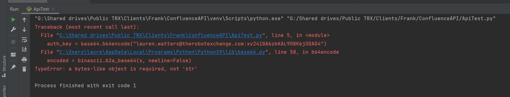

This left me with the following error:

Jacob Brunson
September 3, 2021
Hi Lauren!
I apologize for the bad b64encode instructions. I was testing using the outdated Python 2, while you're using the modern Python 3. The code I should've posted is:
auth_key = base64.b64encode(b"jacob@example.com:abc123cyz").decode("ascii")
Regardless, your use of an online encoder should work just as well!
