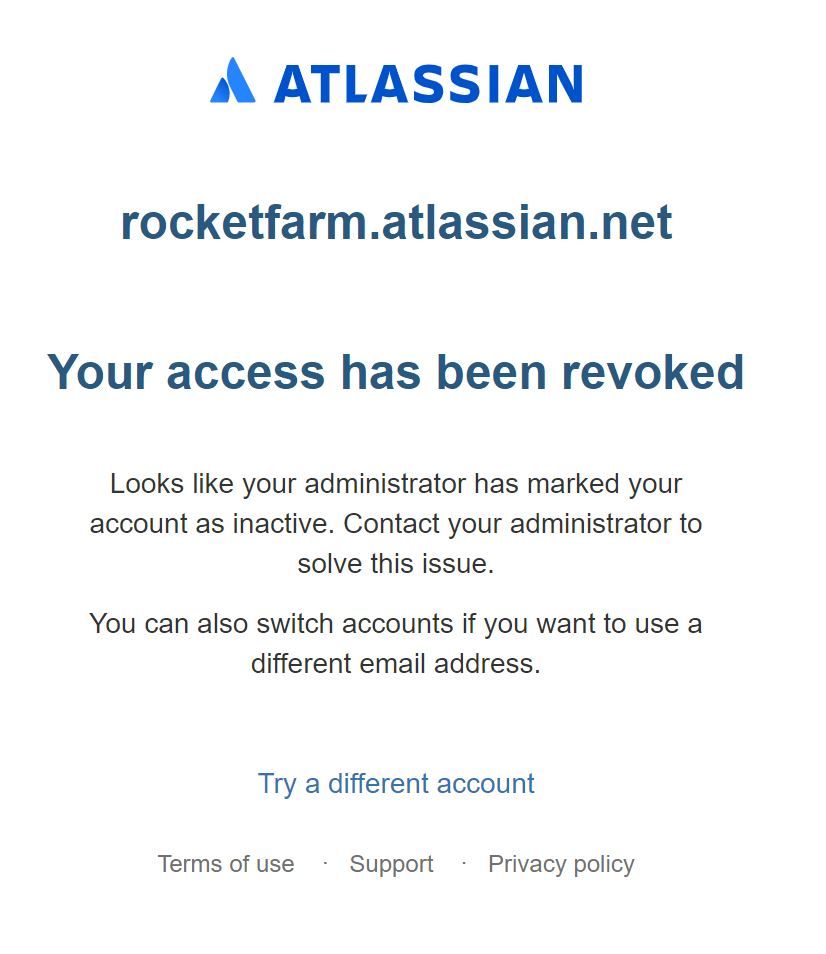

I also have this problem with our customer (Rocketfarm.no).
The space have global permission, but logged in customer can not enter the page. If they go inkognito or not logged in they have access. Strange
