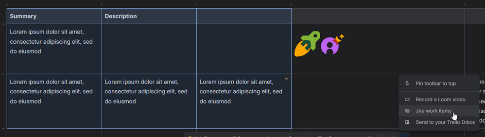

Those larger tables (or content in general) can be a bit tricky. If you're open to manually doing the conversion, you could simply select the cells/rows and then use native integration and option to create Jira work items from those:
