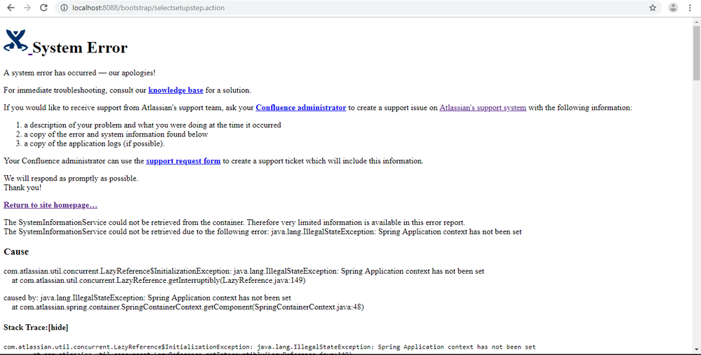

Wanted to connect both of them so I started Jira server and immediately my confluence server crashed. Giving me the following error:
Cause:
com.atlassian.util.concurrent.LazyReference$InitializationException: java.lang.IllegalStateException: Spring Application context has not been set
    at com.atlassian.util.concurrent.LazyReference.getInterruptibly(LazyReference.java:149)
caused by: java.lang.IllegalStateException: Spring Application context has not been set
    at com.atlassian.spring.container.SpringContainerContext.getComponent(SpringContainerContext.java:48)
Afterwards, I have uninstalled and reinstalled confluence and jira but it didn't help.
As of now, I don't need Jira so it it uninstalled. I only need Confluence.
Kindly let me know what I am doing wrong.

Hello there @Raunaq Kumar !
This issue is know and listed in one of our articles here:
There are many causes for this issue. For that matter, I recommend that we start by checking the permissions for both <confluence-home> and <confluence-install> folders.
The essential permissions for the user running Confluence are read, write and execute on both these folders, sub-folders and files.
Remember that running Confluence as root is not recommended. The installer automatically creates a user for the system to use Confluence. You can check more information about the installation process here:
Keep in mind that the install procedure is different based on your base operational system.
Let us hear from you Raunaq! Looking forward to your reply.
