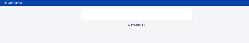

Im trying to install an atlassian suite on Kubernetes. But having some problems with Confluence. I have just setup the pv and pvc and tried to install the confluence helm chart again, the confluence pod is running.
When I try to access confluence it is stuck on a setup page (see attached image)
setup/dosetupstart.action?setupType=custom&atl_token=
Logs from the pod are also attached below.
Can anyone point me to a cause of this?

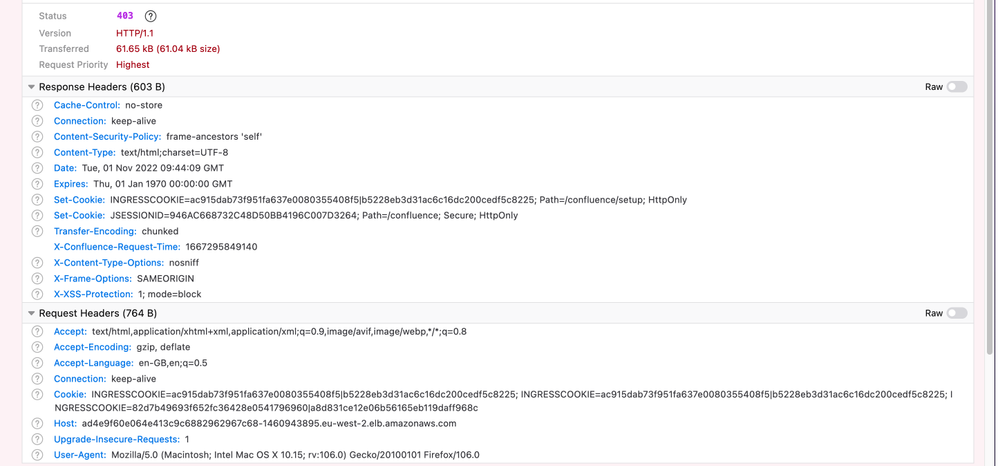

@Ross Brook do you see any errors in browser dev console? Also, can you can logs from /opt/atlassian/confluences/logs?
Ross Brook
November 1, 2022
Hi @Yevhen , thanks for the response, these are the logs from /opt/atlassian/confluence/atlassian-confluence.logs & also here is the 403 I see in the console.
root@confluence-0:/opt/atlassian/confluence/logs# cat atlassian-confluence.log

Yevhen
November 2, 2022
In one of the solutions I found it was a missing trailing slash in the URL. Can you give it a try with it? It can be context path + some ingress weirdness.
