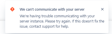

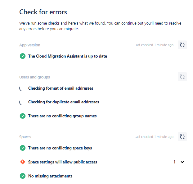

At this juncture  or earlier I start seeing pop ups "we cant communicate to your server:" and the  "check for error" screen hangs forever with the items  "checking format of email address" and "checking for duplicate ..." going round in circles .
See attached pictures below

I continue to see "We cant communicate to your server"
However ignoring that message and also ignoring warnings owing to "incorrect base URL"

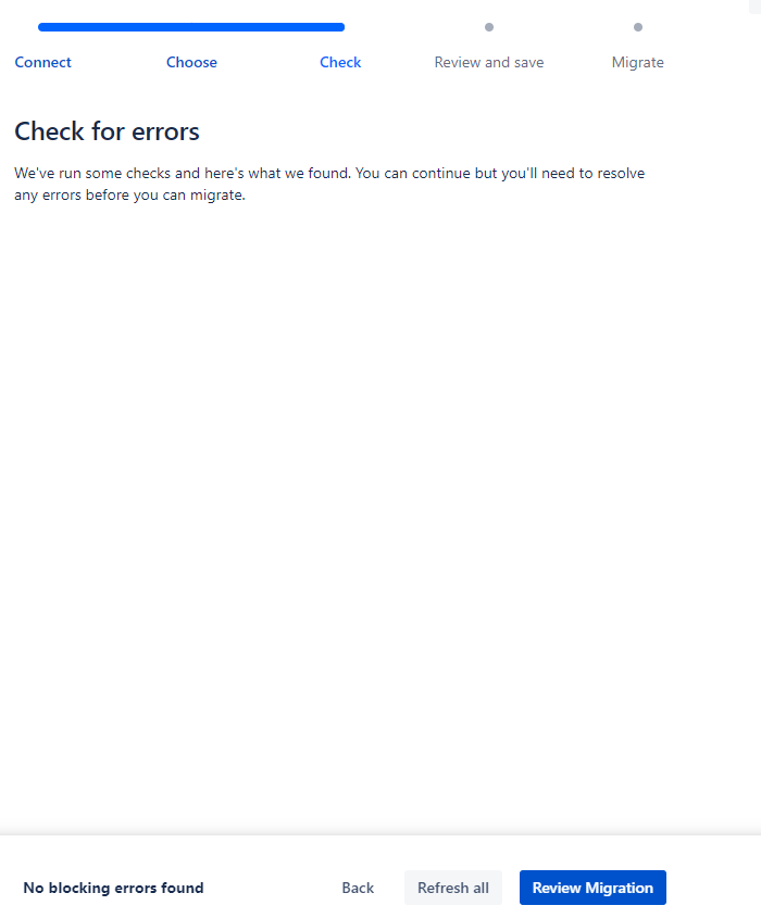

I could finally get to a blank  "Check for errors" screen on which I see a "No blocking errors found" message and "review Migration " button enabled .
See below
So looks like I am past this  stumbling block
So  moral of the story --
The migration assistant  Version: 3.3.2 should be used from direct URL
It Will not work behind a proxied URL
You have to use direct URL
Thanks for all your help
