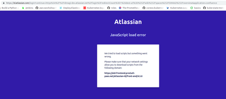

June 23, 2019
Hi Shannon,
I am not able to choose the new cloud site for migration
when I clicked on "choose cloud site" and it gives the below error and I am using chrome browser
error:
We tried to load scripts but something went wrong.
Please make sure that your network settings allow you to download scripts from the following domain:
https://aid-frontend.prod.atl-paas.net/atlassian-id/front-end/4.5.0
Thanks,
Sanjay
SMS
June 24, 2019
Sanjay,
Thank you for providing that screenshot. Have you given that URL to your network administrators? They can make sure that your network isn't blocking access to that domain.
If they can confirm it isn't being blocked, then I'd ask for you to clear your browser cache and then try to login to http://id.atlassian.com/. Let me know if you are able to!

Sanjay Chinthala
June 24, 2019
Hi Shannon,
This is happened due to the firewall issue and I have admin access for 2 confluence cloud site while I am planning to migrate to second confluence cloud site it not showing in the list
