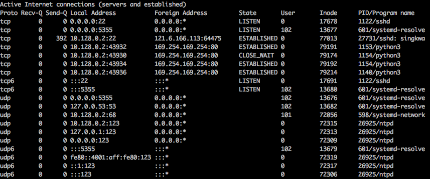

Been trying to get confluence server working on an Ubuntu VM (17.10) running on Google cloud compute. I followed the instructions here: https://confluence.atlassian.com/doc/installing-confluence-on-linux-143556824.html and installation showed no errors. However, I tried to connect (through SSH on my local) to http://localhost:8090 but there was a connection error. Tried checking netstat, and it seems its not running if not it should show up for port 8090?
Not to sure what to do now. I did another check as described by running this command  = ps -ef | grep confluence and it does not seem to be running. Also tried restarting it again by running sudo /etc/init.d/confluence start and again no errors but still confluence doesn't seem to be live.

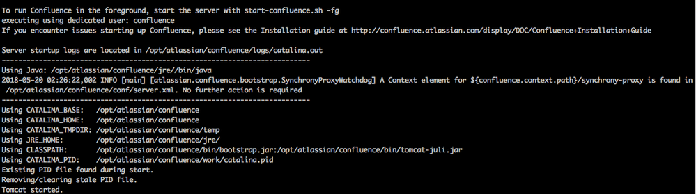

Thanks for including screenshots! Very useful for seeing what's going on.
Can you take a look at the application log file? It's getting so far as starting so at least the init script is pointing at the right place. The application log will hold more information about why it's not staying up.
According to your screenshot, this should be at /opt/atlassian/confluence/logs/catalina.out - this will just grab the last few lines of the file:
sudo tail -n 15 /opt/atlassian/confluence/logs/catalina.out
