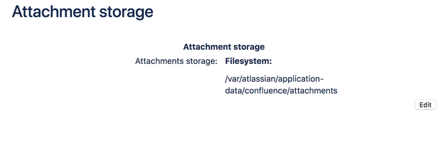

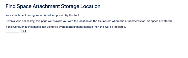

I'm trying to verify if my attachment is still there using <confluence url>/admin/findspaceattachments.jsp according to this link https://confluence.atlassian.com/doc/hierarchical-file-system-attachment-storage-704578486.html
However it says that my attachment configuration is not supported by this tool even when I'm using the filesystem configurationScreen Shot 2018-06-22 at 7.38.12 PM.png

That KB is for a very old Confluence version, so it might not work on your current code.
I would recommend to first check the path that attachment is expected at inside <Confluence_home>/attachments folder (get path from URL or look for missing attachments errors in atlassian-confluence.log), if you can not find the file in the specified path then use the first part of the KB and see if you can locate the file from attachments ID. In cases where structure was changed due to migration, it could be that attachments are still in the system, but under slightly different path, if that is the case, then the script from the KB can be used in combination with DB query, as it's basically designed to locate attachments per ID and move them to the right directory.
If you can't locate any files associated with attachment ID on the disk, then you should restore the contacts of attachments directory from backup, merging them with existing and then do a full re-index and if doesn't help, re-index from scratch.
