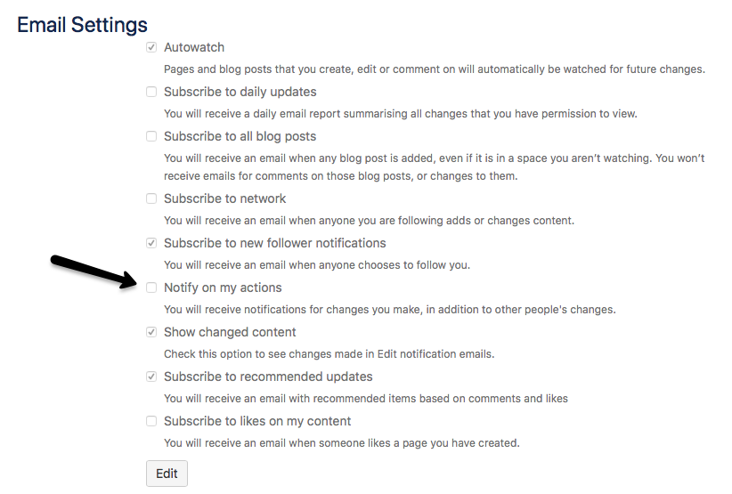

Look under Settings-> Email and if you don't have the following checked, then you will not receive notifications for changes you make.
The add-on could possibly be impacting your notifications. Can you test again on another page?

I applied this setting. Success.  On the page without News Teaser add-on module it works for me.
