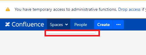

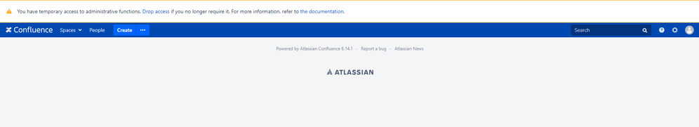

I have a self hosted confluence among Jira. Once I have gone successfully throught the configuracion, connecting it with the database, I go to the main page but I find many problems:
- I dont see nothing in the main page
- I cant see a list of spaces (I have two created) or create or anythingUntitled.png
- Create from template spins until forever (I have seen some isues related, but nothing worked, not enablig apps, disabling, installing, database issues... nothing)

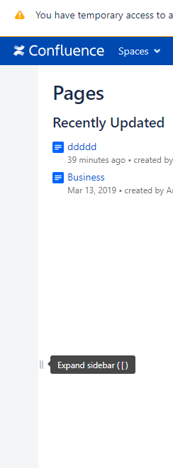

- Where is the left bar?

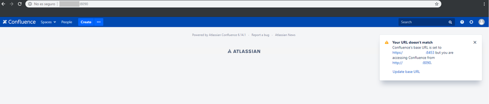

Hi,
are you using reverse proxy? Can you check if problem is also exist if you access it directly on java port (for Confluence is default 8090)?
Let me know
petramika
March 21, 2019
Hi Peter,
Thanks for your answer. I thought on this but yes, still this happens.

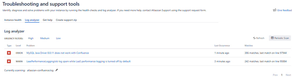

I am thinking that his might be a java mysql connector issue. At the moment, I am using  mysql-connector-java-8.0.15.jar. I saw that confluence in ubuntu 18.04 should use the connector mysql-connector-java-5.1.*.jar but I did not found any trouble in the configuration menu.
I tried to clone the steps at Download and install the MySQL driver in case is was this, but I dont know how to point to the new 5.1 connector, is still working with 8.0.15.jar (where is the file I should change??).

Ok, so my log is quite big, I leave the output from troubleshooting, and I leave you with a public temporally address where you can see last lines of the output log
u.pngI do not have a proxy server configured, I made a certificate with Let's Encrypt and point to it following this tutorial, but without doing this is still working wrong... I did not had any problems with Jira.
