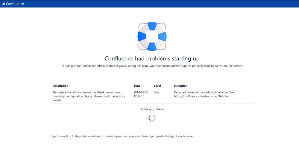

Hello,
I have confluence server, but today he's offline. Does anybody has a solution, I looked into the links on the error-page, but I don't understand a lot of it... ?
Server is working normal ...
thank you,
kind regards,
Pieter-Jan

Hi,
The error message indicates that the collation level of your database (MySQL) is not setup correctly.
If this is a production system please check https://confluence.atlassian.com/kb/how-to-fix-the-collation-and-character-set-of-a-mysql-database-744326173.html on more details and what your database admin should check and do.

Hello,
thank you for your answer. I have no experience with mysql database ... So could you advise where I can get support for this?

Hi,
Atlassian provides a good and detailed resource on how to setup MySQL at https://confluence.atlassian.com/doc/database-setup-for-mysql-128747.html
