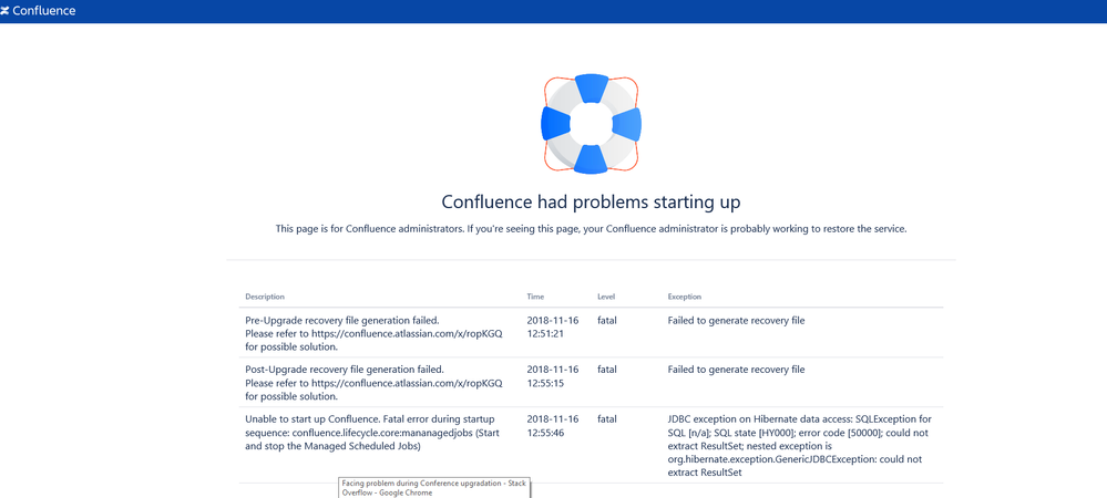

Peter_Lücke November 27, 2018
Hello Shannon,
I guess I have also a similar situation. I am getting the following error:
In my case i guess my database is h2 and mine is test confluence. Please suggest what to do.

Peter_Lücke November 30, 2018
Hello shannon,
As per your suggestion and confluence documentation I have reverted back my confluence to the older version. Install MYSQL as an external database and install the same version on a different directory (same server). Then I have installed the new version 6.12.2 but unfortunately, got the following errors:
Description:
Pre-Upgrade recovery file generation failed.
Please refer to https://confluence.atlassian.com/x/ropKGQ for possible solution.
Post-Upgrade recovery file generation failed.
Exception:
No operations allowed after connection closed.
Please suggest something to solve this problem.
