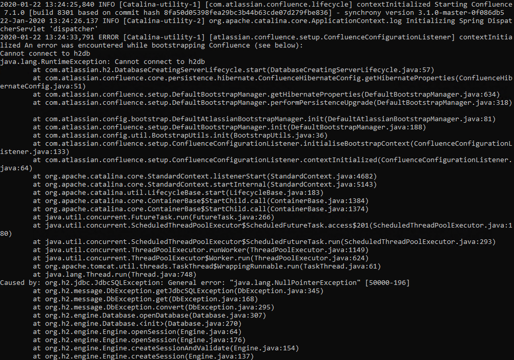

Cryptomathic
January 22, 2020
Below is the error message from the console.
Cryptomathic
January 22, 2020
