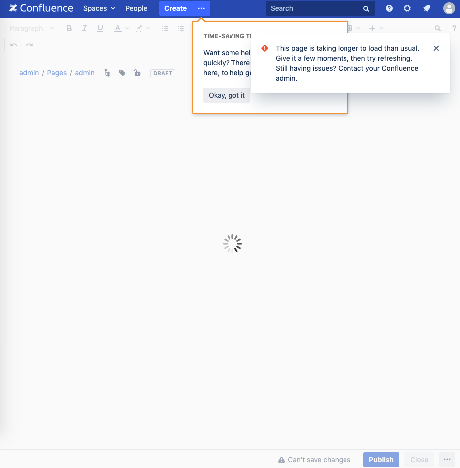

I am running an confluence docker on my local macOS with the Trial DB option. It is a flesh installation.
I cannot enter the edit page when I click the "Create" button.Screenshot 2019-05-02 at 11.09.52 AM.png

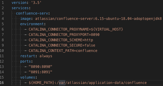

docker image atlassian/confluence-server
https://hub.docker.com/r/atlassian/confluence-server/
image: atlassian/confluence-server:6.15-ubuntu-18.04-adoptopenjdk8
version: '3.5'services: confluence-serv: image: atlassian/confluence-server:6.15-ubuntu-18.04-adoptopenjdk8 environment: - CATALINA_CONNECTOR_PROXYNAME=${VIRTUAL_HOST} - CATALINA_CONNECTOR_PROXYPORT=8090 - CATALINA_CONNECTOR_SCHEME=http - CATALINA_CONNECTOR_SECURE=false - CATALINA_CONTEXT_PATH=confluence restart: always ports: - "8090:8090" - "8091:8091" volumes: - ${HOME_PATH}:/var/atlassian/application-data/confluence

Hi,
From first impression.
1.The page loading is failing because synchrony service is failing.You can turn off collaborative editing(admin section confluence) and page creation/saving will work.
2.It might be failing because you have to set the synchrony base url path in setenv.sh.
admin
May 1, 2019
I found collaborative editing is under good status but you are right. The page creation/saving is working after turn off the editing mode. Thank you.
