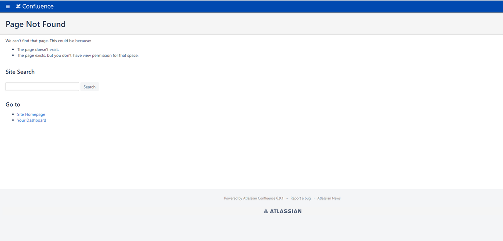

Neil Anthony Morada
November 22, 2021
Hi @Davin Studer
We have a problem on synchrony and when I access this
http://{ourserver}:8091/synchrony/heartbeat it shows this
I already changed the synchrony port to 8092 and the memory heap size to 2gb and still no effect on error.
Btw, our confluence and synchrony runs smoothly for a year and suddenly encountered error.
Thank you!
