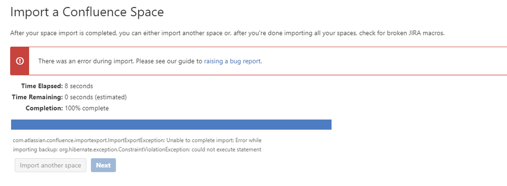

This is the error I am getting:error.PNG
and then I tried to factory reset confluence and done a another import, still having errors, and this time is a different one:
com.atlassian.confluence.importexport.ImportExportException: Unable to complete import: Error while importing backup: could not execute statement; SQL [n/a]; constraint [uk_jp1ad5yufsih5r7lqrygakpug]; nested exception is org.hibernate.exception.Constraint
Could anyone help, please. Thank you.

Sharon,
Could you confirm with us from what version of Confluence the space export originated?
Did the export not complete despite the error? I have had quite a few exports that errored out but still ended up completing.

Deleted user December 9, 2017
Hi Shannon,
Thank you for your response. with some help from a colleague, we have figured out what the issue is, i.e. why successfully exported file cannot be successfully imported: The space has previously been exported and imported before, so there are duplicated spaceName and key in the export .xml file and properties file. Some lines has the key of "“HTWTR” whereas other lines has the key of “EIP”.
I am not sure about the cloud instance details. I still need to import the contents, which are in a confluence export zip file contains the attachment folder with all attachments, a .xml file and a properties file.
I don't have the .xml file and property file with me right now (I m using my home computer, not work computer right now).
Do you have any suggestions? I was going to raise a Confluence support case for getting help from someone to correct the .xml file and properties file.
