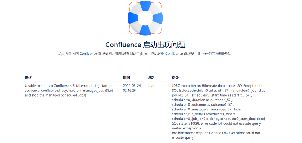

Confluence can't start after the server restarts

Hi @易阳
Thanks for posting and sorry to see you've had this issue. From the error you've posted there's a issue with your database, more likely the database hasn't started or Confluence can't connect properly.
Can you check your database? If you're unsure, the credentials are in confluence.cfg.xml
Check the database is configured correctly and running. If it is, then ensure Confluence can access the database tables though the same username/password in confluence.cfg.xml.

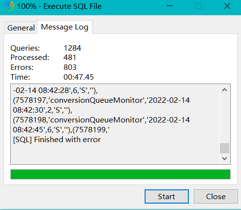

But I will make mistakes by backing up mysql and importing SQL through navicat. 微信图片_20220324113804.png

Hi,

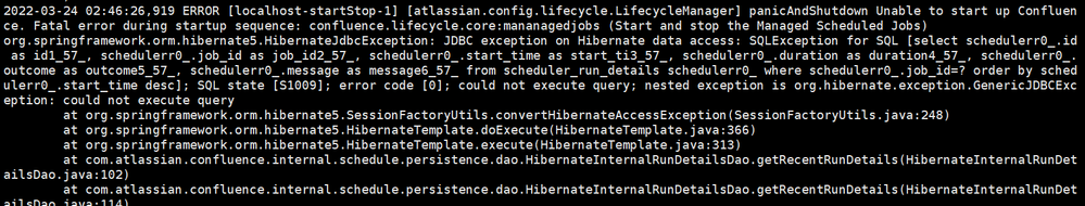

Then it's likely you have a data corruption. If you have a stable backup then I'd suggest you restore from that and don't mess with the system.
Usually the stack trace has right down the end a message of Caused by it would be good to see what to original cause was.

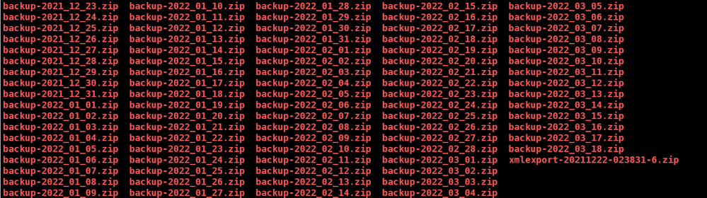

James Richards
March 24, 2022
Hi,
It looks like you have nightly backups still turned on. The file backup-2022_03_18.zip is likely to be a full backup. You can restore your site by following these steps

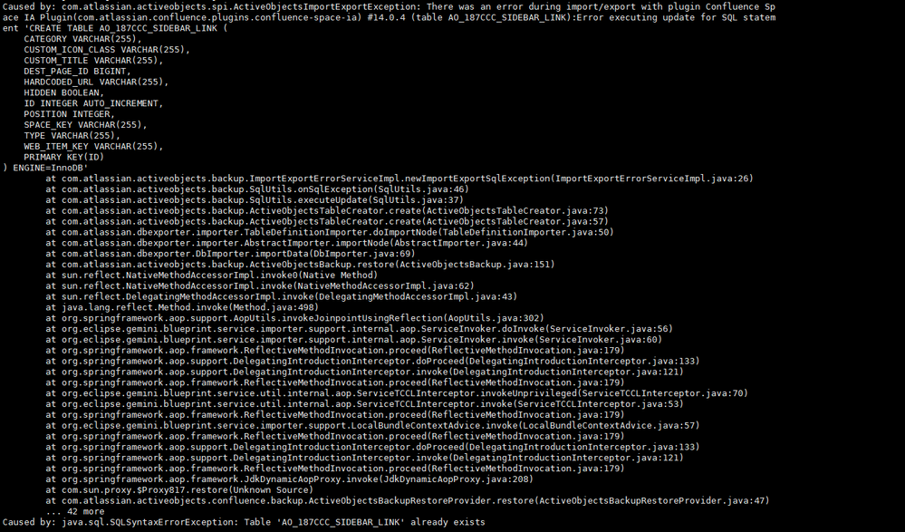

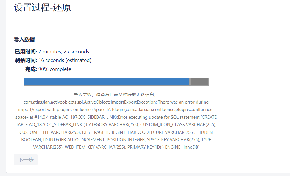

易阳
March 24, 2022

Hi @易阳
Are you using the same version of Confluence and MySQL to do the import? And what versions are you using?
Regards,
James.
易阳
March 24, 2022
It's all the same version
