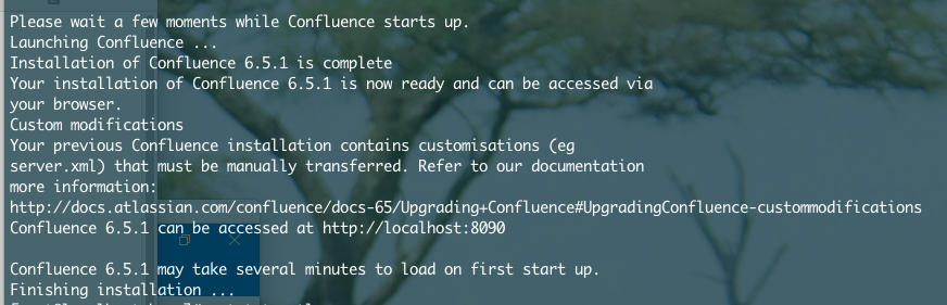

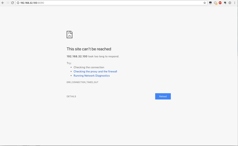

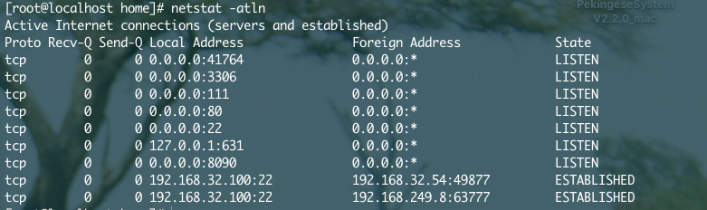

hello:
I upgraded from 5.10.7 to 6.5.1 and executed ./start-confluence.sh. Display port has been listening, but can not open confluence
OS:Centos6.8
