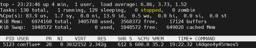

Jona Lama
November 25, 2021
Hello all,
I had the same problem until today. Now instead of javaUpdate, are showing unknown proccesses. I try to kill them but they appear with another name and PID. they created folders within confluence installer folder and also they modified crontab file.
I think its a ddos attack. How can i get rid of it?

jpedrot
November 26, 2021
You should reinstall your system to be 100% sure.
But remove the crontab entry and killall the processes and remove the files.
Upgrade confluence to latest version.
Monitor if something weird is going on, look at Netdata (https://www.netdata.cloud/) for easy monitoring.
