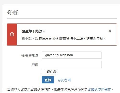

Dear Partners,
We have one ldap account named guyen thi bich hang , he can login operating system but he can not use ldap account to login confluence, it always showed his account and password is wrong. What happen to the account? Thanks a lot.
login confluence message

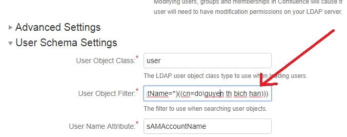

Anderson Hsu
November 19, 2017
Dear Ann,
I use filter function as listed as below. But It can not filter the right account. Is there suggestion about filter setting ? Thanks a lot.
AnnWorley
November 20, 2017
To filter out a user, please use the ! sign as described in How to write LDAP search filters under Using 'not'.
If you were to add one user to the user filter without the ! sign it could potentially filter out every user except the one you specify.
The LDAP filter will not accept the AD name in the format domain\username (do\guyen th bich han). The entire distinguished name is necessary to specify the user. Please see: Distinguished Names.
You can find the user's distinguished name in Active Directory Users and Computers when you view the properties of the user under the object tab. If you don't have access to AD then the AD administrator should be able to provide you the distinguished name.

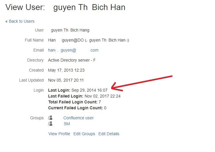

Anderson Hsu
November 5, 2017
Dear Ann,
Thanks for your kindly reply. We found the successful login record in his profile information, but I think it's duplicate account from another domain.
account2.jpgI have ever try to add the account in global permission setting, but it still can not successful to login . How can we delete previous the same account  record which it's maybe from another domain record.
Best Regards, Anderson Hsu
