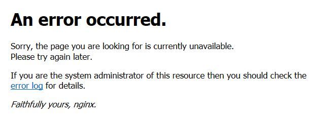

Hi, I upgraded our Confluence 6.2 to 6.13.5 and the log stated:
entireUpgradeFinished Upgrade completed successfully
However, when going to the url I get an NGIX error as per image below, not very helpful in its direction.  I checked the upgrade tasks from intermediate release notes here....

Resolved it!
The upgrade, for whatever reason reset the proxyname port numbers from 8092 to 8090 so it obviously then had trouble connecting using the proxyname we use in our links (and set as the base URL in settings).
I noticed we had to nginx dir on our drive and I typically managed to pick the wrong one when viewing the log file hence no evident reason for my connection error.
Confluence was upgraded successfully and was requiring the servername:<portnumber>  or IP:<portnumber> in order to allow access.  our host proxyname is "apconfluencetest" as can be seen below.
The nginx error was:
2019/06/10 23:08:55 [error] 1632#11472: *10 upstream timed out (10060: A connection attempt failed because the connected party did not properly respond after a period of time, or established connection failed because connected host has failed to respond) while connecting to upstream, client: 10.128.12.159, server: apconfluencetest, request: "GET /dologin.action HTTP/1.1", upstream: "http://10.242.130.12:8090/dologin.action", host: "apconfluencetest"
Changed port numbers in the nginx.conf file, restarted nginx service and all seems well.

Confluence will always modify the server.xml file when being upgraded. That’s why you get a list of modified files that you should review.
Glad you solved it,

we cannot see the image...

Richard
June 10, 2019
apologies, not sure how that happened:
Richard
June 10, 2019
It doesn't point me to specific log and having checked the NGINX directories I don't see anything of note in the log files that exist there
