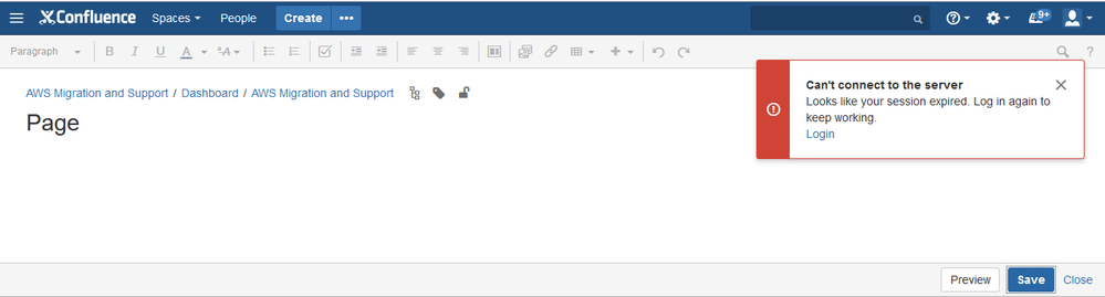

After upgrading confluence from 6.0.4 to 6.2.0, It works everything fine, but when i try to Save new page, suddenly i got errors like below :
Can't connect to the server
Looks like your session expired. Log in again to keep working.
So i am trying more alternative ways but unable to fix it. So how can i resolve this issue ? It's production server and please reply as most as earlier

and one more thing, i am able to save documents in Google Chrome but not in Mozilla as well as IE .

Hi @Ann Worley, Thanks for your quick reply, In my server there are running bitbuckt, confluence, jira etc.  I have tried tried that link but still getting same issue, for more understanding here i attached my screenshot and context.xml file.
Context.xml
<?xml version='1.0' encoding='utf-8'?>
<Context sessionCookieName="CONFLUENCESESSIONID">
    <WatchedResource>WEB-INF/web.xml</WatchedResource>
    <WatchedResource>${catalina.base}/conf/web.xml</WatchedResource>
    <Valve   className="org.apache.catalina.valves.CometConnectionManagerValve" />
</Context>
Error:
