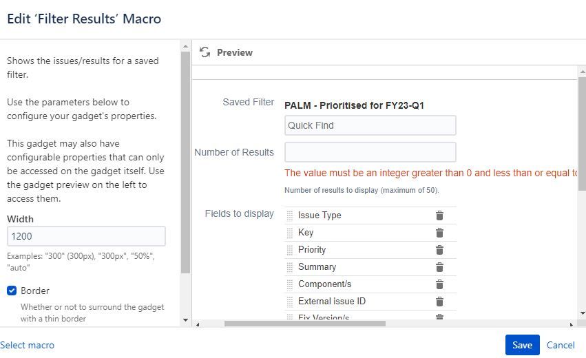

I am using a Filter Results Macro to fetch my filter results. And then I am using a Table Filter Macro for Filtration. I am trying to follow your suggestion of using pagination only on the Table Filter Macro. However the issue is that the Number of Records field in the Filter Results Macro is mandatory. (pls see attached screenshot. We have to enter a value between 0 and 50).
So I am having to select it as 50. The number of results retrieved by my filter query is around 403.

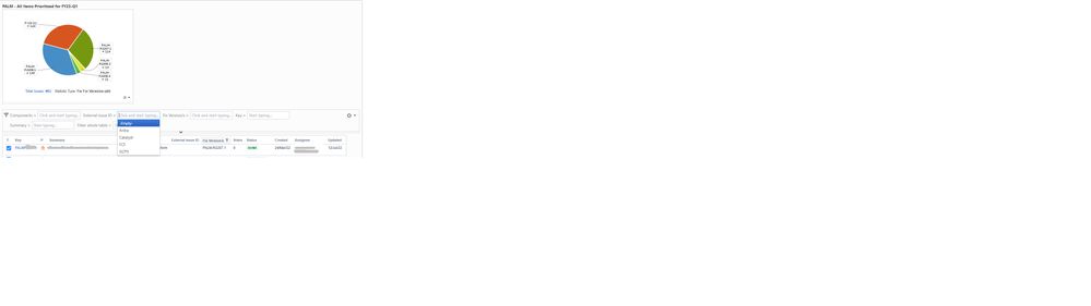

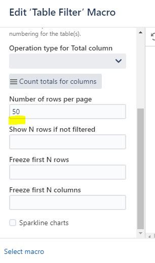

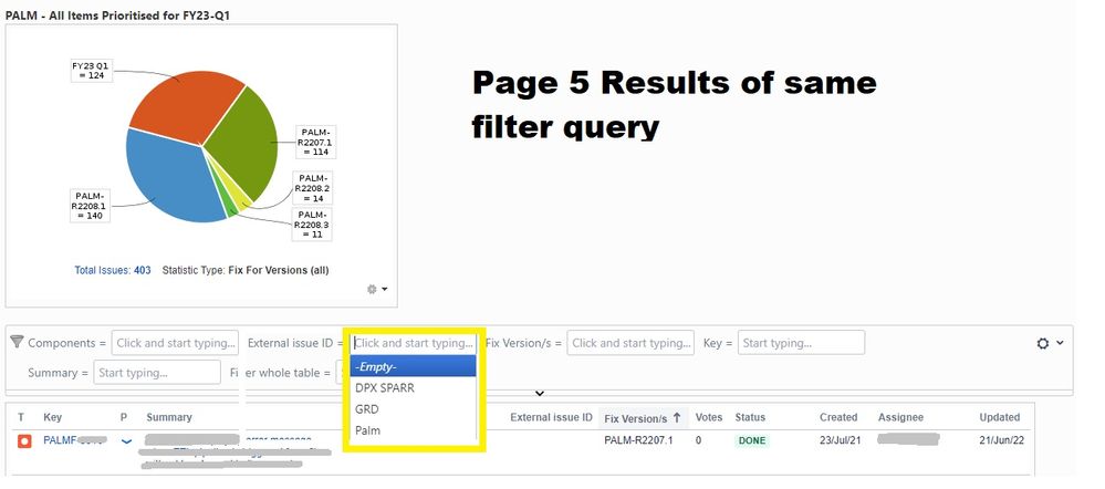

Then I am selecting the Table Filter Macro -> Table View Tab -> Number of Rows per Page as 50. I am saving all the changes and I still see the filtration is happening on page 1 only. Please see additional screenshots attached by me - Filtration for External Issue ID field on page 1 shows only values of the first 50 records. But the filtration for the same field on page 5 shows values for that page.
My expectation is on page 1 it self the filtration for External Issue ID should display all unique values in all records retrieved. Please let me know if my expectation is right or is there anything I am missing here.

@Katerina Kovriga _Stiltsoft_ additional screenshots here of filtrationFilteration pg1.jpgFilteration pg5.jpg on different pages
