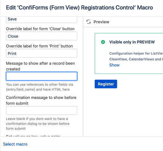

And another question just fort improving the usability. Is it possible to get a confirmation dialog after successfully creation of there jira task or successfully sending?
Alex Medved _ConfiForms_
June 17, 2019
For dropdown fields you can access labels, by doing
[entry.Position.label]
See more details for available properties in each field type here https://wiki.vertuna.com/display/CONFIFORMS/Accessing+field+values+and+properties
As for the confirmation message see and set the corresponding parameter in the ConfiForms Registrations Control (FormView) macro

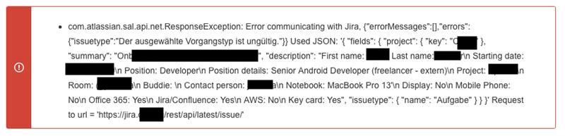

Hi @Alex Medved _ConfiForms_ , we have an unexplainable problem. When I send the form it works. If another user sends it, he gets the following error with the same data.
imgo.jpgDo you know why that happens?
With best regards Thorsten
June 18, 2019
What does it tell in the error? (I dont understand German!?) Does the user who attempts to submit the form has enough permissions in Jira to create issues of this type?
thorsten1304
June 18, 2019
"The choosen issue type is wrong". Normally that user can create that issue type in Jira in the same project.
June 18, 2019
Can you confirm the user can access the Jira project and create issues of the "Aufgabe" type?
thorsten1304
June 18, 2019
In the Jira project the user itself has the access to create such a task.

It must be an access and permissions issue. Could you please open the ticket with us and provide your form configuration and json reported in the error?
June 26, 2019
Just to confirm the outcome - issue type "Aufgabe" was incorrect and that has resulted in the error mentioned earlier
thorsten1304
June 26, 2019
Issuetype "Aufgabe" was coireect but I had to use the id because of a not correct naming of our fields. Now it is solved
