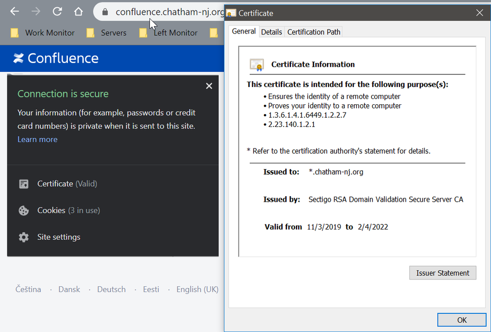

Michael Santangelo
July 20, 2020
You understand correctly.  Please see the attached screenshot from Chrome on a Desktop.
All users attempting to connect to Confluence via mobiles are using Android phones.  After typing in confluence.chatham-nj.org at the app screen all we get is:
We are using Confluence Server, self-hosted, version 6.14.3.
