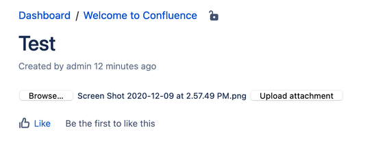

I've created a very simple scripted macro for this example. It adds a form to the page that lets the end user upload an attachment to the page that they are on. Obviously, that's not very useful by itself, but it at least should give some idea how to interact with Confluence's REST API for attachments from JavaScript.

The result should look something like this:
I assume that for your use case, you'll want to do things like target a different page for the attachments, or something along those lines. That could be accomplished by adjusting the pageId variable in the above JavaScript.
