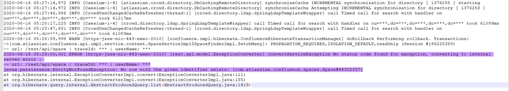

Upon checking the logs the below error is reflected.
Can you help with the resolution?

It seems to me that you have Confluence Space that is deleted from database but might still be in cache for some reason.
Could you try to reboot Confluence and then call the REST endpoint again?
But also go through your Confluence Spaces and see if any errors are occurring in the UI.
