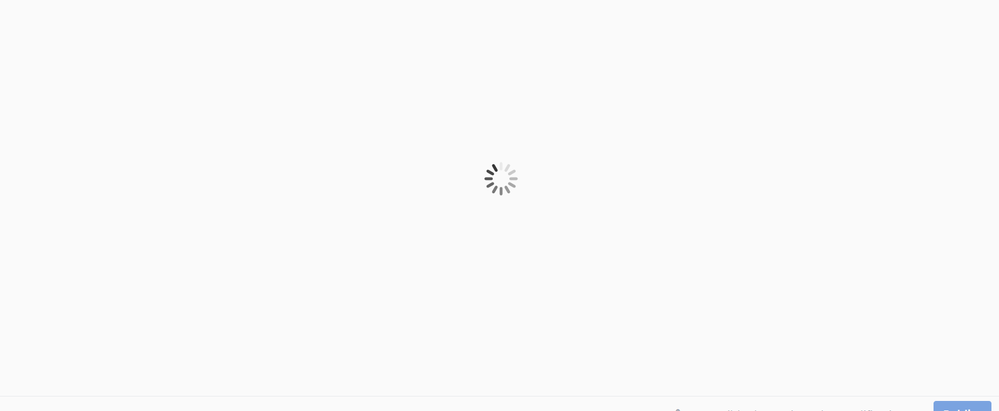

i migrate my confluence 6.14 to 6.15.1 ,all was done correctly, but now when i click on Create, the page stay on Loading (screenshot) .
