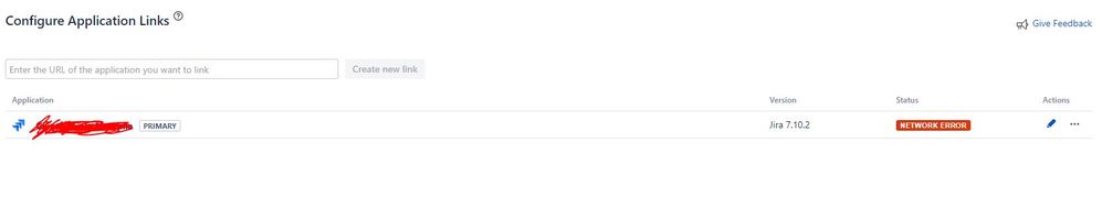

I had look at the application link on confluence and it's have a network error. Not sure what it's required on the reverse proxy ( IBM Webseal) to avoid this network error. The Jira application is working fine otherwise .

Dear @Wisam Abdelaziz,
best you remove both links and re-create them. When using self-signed SSL certificates, make sure, that the JVM(s) "knows(know)" them. Otherwise the applinks will not work.
See this troubleshooting guide from Atlassian.
