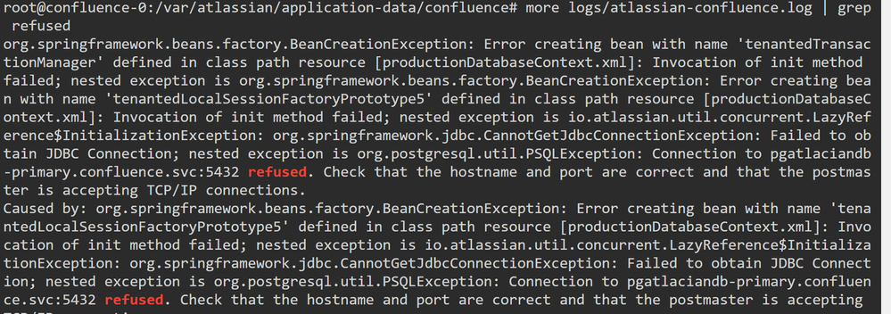

Environment : Killercoda
DB : Crunchy Postgres
Below externally (from postgres-client pod) able to connect DB
Error below

@PKAR in your test pod you are using a different hostname while Confluence tries to connect to
pgatlaciandb-primary.confluence.svc

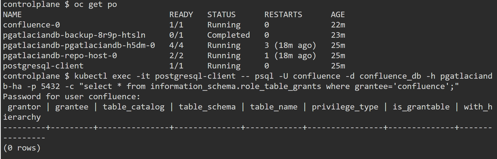

PKAR
August 5, 2024
yes, pgatlaciandb-ha.confluence.svc but I tested with both, same result.

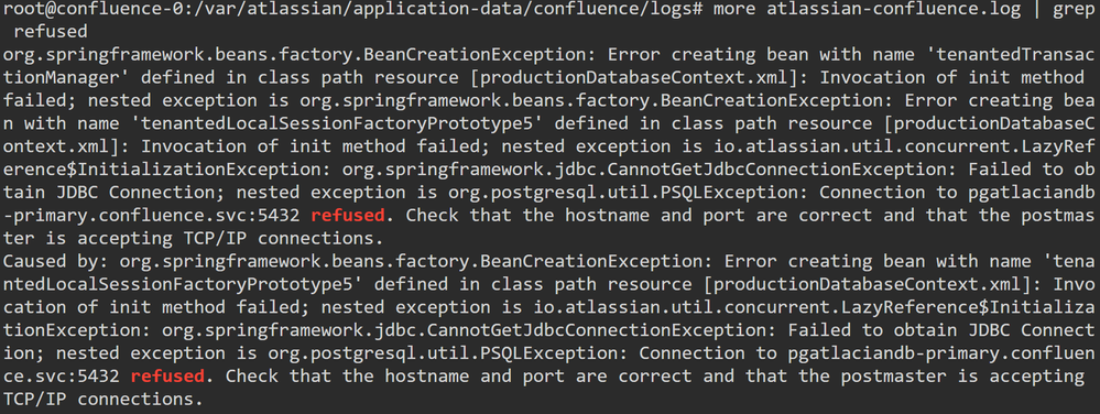

PKAR
August 5, 2024
I modified  forceConfigUpdate: trure in values but same error. Even from POD I think it will connect.

You still have
jdbc:postgresql://pgatlaciandb-primary.confluence.svc:5432/confluence_db
in your values file.

I have tried your configuration and Confluence pod passes readiness probe. Can you share output from kubectl get pods?
