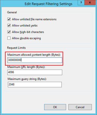

Turned out it was Request Filtering on service.
maxAllowedContentLength by default is 28.6MB
Select it on the IIS service, Edit Feature Settings and just add an extra 0 and it will raise it to 286MB.
Confluence on WINDOWS Server 2016 Standard
