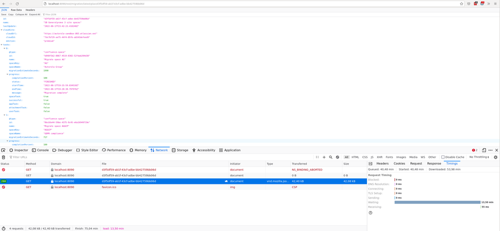

This is an example of a REST endpoint that triggers a very log delay.
It seems to cause this query to hang for a long time:
select tasks0_.planId as planid13_18_0_, tasks0_.id as id2_18_0_, tasks0_.taskIndex as taskinde3_0_, tasks0_.id as id2_18_1_, tasks0_.taskIndex as taskinde3_18_1_, tasks0_.planId as planid13_18_1_, tasks0_.endTime as endtime4_18_1_, tasks0_.message as message5_18_1_, tasks0_.completionPercent as completi6_18_1_, tasks0_.doneResult as doneresu7_18_1_, tasks0_.startTime as starttim8_18_1_, tasks0_.executionStatus as executio9_18_1_, tasks0_.weight as weight10_18_1_, tasks0_.spaceKey as spaceke11_18_1_, tasks0_.scoped as scoped12_18_1_, tasks0_.taskType as tasktype1_18_1_ from mig_task tasks0_ where tasks0_.planId='d3f5df59-ab1f-43cf-adbe-bb42759bb06d';
Curiously, this query executes immediately when run from `psql`
This, of course, not on the same system, but on an AWS Amazon Linux instance.
CCMA is 3.3.7.
Query obtained from modifying a query shown from the following:
SELECT * FROM pg_stat_activity where datname = 'confluence7_13_7' order by backend_start;
Interestingly, though, that query referenced "MIG_TASK", not "mig_task" but dunno if that could cause trouble.
