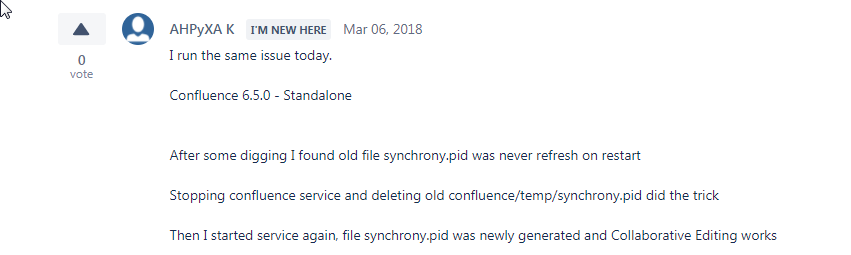

I was able to get this working.  I BELIEVE what finally made it work was deleting the synchrony.pid in the C:/Program Files/Atlassian/Confluence/temp/ directory.  which I read about in a very hard to find post that I've linked below.  The only other change that I made before it started working was adding a line to the system properties:
-Dsynchrony.proxy.enabled=false  which from what I understood should tell Tomcat not to use the internal proxy for Synchrony.  I deleted the line and restarted again and it still works which tells me the below fix was what I needed.  I don't know if this is intentional or not, but this issue cost me hours and hours of circling around and quintuple checking everything.
