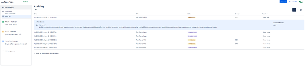

Claudio Palmeri
September 12, 2023
Here it is, including error message.

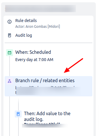

Aron Gombas _Midori_
September 13, 2023
@Claudio Palmeri We have an automation that also runs a CQL search periodically, but we use a different component, not the "if" block.
Can you try the "Branch rule / related entities" block?
(Otherwise I totally agree with @Mike Monk's idea what is the actual root cause in your case.)
September 13, 2023
I am not sure that I understand the question...
But if you asked if the rule configured this way processes all pages and each page separately, then the answer is yes. It actually works for me (prints the page names one by one to the audit log).
