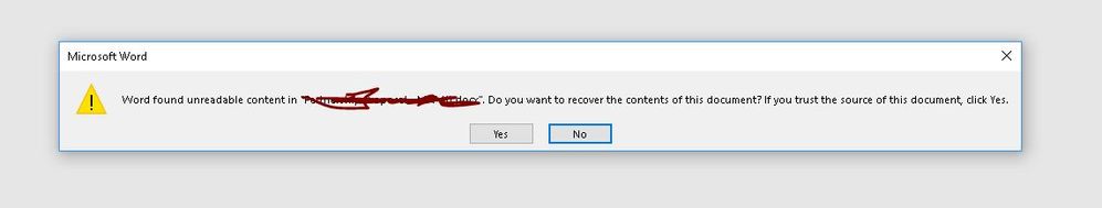

1. I have attached the screenshot.
2. Atlassian Confluence 6.4.2
3. I restored the entire backup of the confluence and while restoring I have included attachment folders as well
4.  I could see all the attachments(not missing), but they are not opening,

I'm assuming the PDF file gets a different error since you're not using Microsoft Word to open it? Is it possible for you to share that error with me? Unfortunately the information you provided isn't really giving me enough to work with.

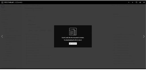

1. I had asked you previously what error you get when you try to open a PDF file, but I don't see that you responded on that. Could you confirm?
Please find the attached screenshot, the error lies within Confluence,

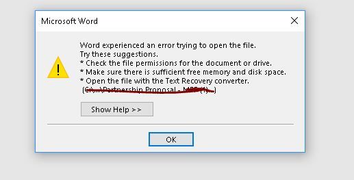

same things happen when I try to open any MS office documents as well.

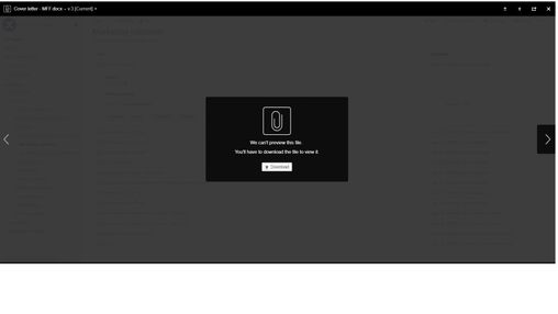

3.Can you please test with the attachments macro or Word macro and see if you're able to preview the files directly within Confluence?
no.

Thank you for providing the details about the error message you receive within Confluence. This is more helpful and we can use this to troubleshoot.
For #3 - when I asked if you can test, you responded with "No" - can you confirm if you meant no, you cannot test, or yes, you tested, and no it does not work?
What we want to follow now is the error messages that occur in the Confluence logs when you get the error message in the UI:
Ouch! looks like this document is broken. try downloading the file to view it.
You'll need to tail your Confluence Server logs when you generate the above error. Note that the error in Office 365 can't help us as it doesn't write to the Confluence logs.
Please provide us what error messages occur in the Confluence logs when that error shows in the UI. That will tell us what is causing the attachment to fail.
