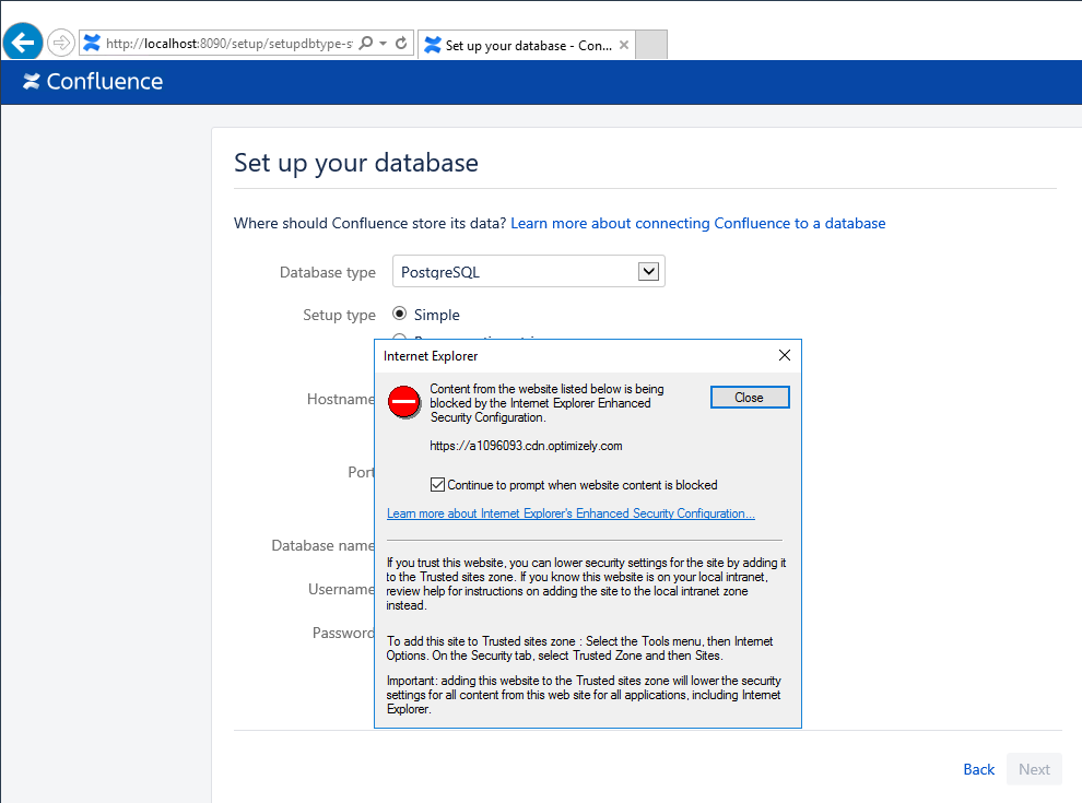

I am installing Confluence 6.8 install on Windows Server 2016 and noticed that during the install there are many IE warnings that a site cannot be reached. The reason they cannot be reached is that our server require that IE enhanced security be enabled.
An example of a site is: https://a1096093.cdn.optimizely.com
There were many more, that came up within the install process. I stopped right after verify my SQL connection for other reasons.
And now my question, what happens if we skip all these internet connections during the install?   Why are they needed?
Thanks
I agree odd if the installer does not need these connections but never the less they are occurring.
To recap, I am running the installer executable (.exe) and when it gets to the setup using a browser these reach-outs to the internet occur.
Right now as I await my load balance point for SQL I am testing my direct SQL connection and going no further.
I use (on server (Windows 2016 )) IE http://localhost:8090 which resumes my install process and am present right away with an IE pop-up stating it is trying to reach: about.internet
I select close and continue onto Set up your data base. Seconds later another IE pop-up for, image inserted above.
I'm sure if I ran remotely these would not occur but trying to document (and understand why). From the executable one is launched into setup where this occurs.

By the way, during testing, I saw the same behavior you describe: there were about 5 blocked requests during the setup wizard whether I launched the browser after the installer or if I launched the browser independent of the installer.
I clicked "close" on each blocked site notice and was able to complete the setup and log into Confluence with IE in enhanced security mode.
I also still saw the blocked sites when I started Confluence with the Marketplace and Analytics connections disabled via system properties as described in Disabling analytics information sharing and Problems Connecting to the Atlassian Plugin Exchange.

Thank you for taking the time to look into. I'll simply close these warnings as they do not appear to affect the install.
