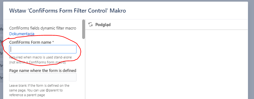

Hi @Alex Medved _ConfiForms_
Is there any way to use Filter Control with TableView Merger without DIV?
Bartosz Drożdżal
May 20, 2024
I would like to use Filter Control with TableView Merger, not with TableView.
From what I found out, this is only possible with the DIV macro.
May 20, 2024
I am sorry, but what makes you think so? There is no need to use the DIV macro
Bartosz Drożdżal
May 20, 2024
How do I refer to a specific form using TableView Merger?
May 20, 2024
Exactly what the parameter tells you - by typing the form's name
Bartosz Drożdżal
May 21, 2024
I use TableMerger to collect data from all over a particular space, so I have several forms. I would then like to filter this data using Filter Control. Is it possible to filter several forms at the same time?
May 23, 2024
Filter Control macro assumes you are having one form (filtering on fields from this form)

Bartosz Drożdżal
May 20, 2024
Without DIV or HTML macro.
May 20, 2024
There is no need to use DIV or HTML macro when you use ConfiForms Filter Control macro
https://wiki.vertuna.com/display/CONFIFORMS/Using+and+configuring+ConfiForms+Dynamic+Filter+Control
