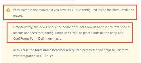

1) This page shows the IFTTT macro inside the form definition macro but when I attempt to insert the IFTTT macro, it always creates it below the form definition macro. Also, when configuring the IFTTT macro, I see this message which is confusing because the first paragraph alludes to being able to create the IFTTT macro inside the form definition, but the second paragraph contradicts it:

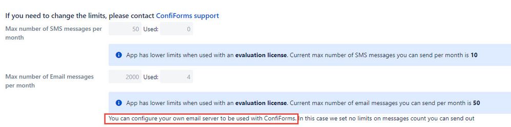

2) Even though I have the Sender field filled with my email address, one success email shows the sender as confiforms-noreply@vertuna.com . I found this piece in the Confluence configuration for ConfiForms that suggests we can configure our own email server, but I can't locate how to do this; however I found this open item that seems to indicate Confluence Cloud doesn't allow email configuration.

1. This depends on the Confluence editor you are using. Is it the one that supports nested bodied macros (they call it legacy editor) or the one that does not (new fabric editor)
2. CONFCLOUD issues are for Confluence, not ConfiForms. We support custom mail servers - see plugin configuration for details
https://<yourserver>.atlassian.net/wiki/plugins/servlet/ac/com.vertuna.confluence.plugins.confiforms/confi-forms-admin
And you dont need a custom email server to change the "sender". It works fine by overriding the "Sender" parameter in the IFTTT macro

Ok thanks for #1. I researched the legacy editor and it looks like I can request that template from Atlassian. If there's a formatting issue inside the IFTTT macro (after every edit, the message body indents/centers from left justified and all formatting is lost) is that a Confluence editor issue or ConfiForm issue?

Not sure what you mean in #1, but we dont control the editor... It is all Atlassian.
We can only control how the macro is rendered

Ok, for #1 I will reach out to Atlassian for formatting issues.

ConfiForms (for Confluence cloud) uses sendgrid facilities for emailing by default
You can always set up your own email server to be used. This is done in ConfiForms app settings
If using your own email server is not an option then consider whitelisting and trusting the 168.245.6.168
