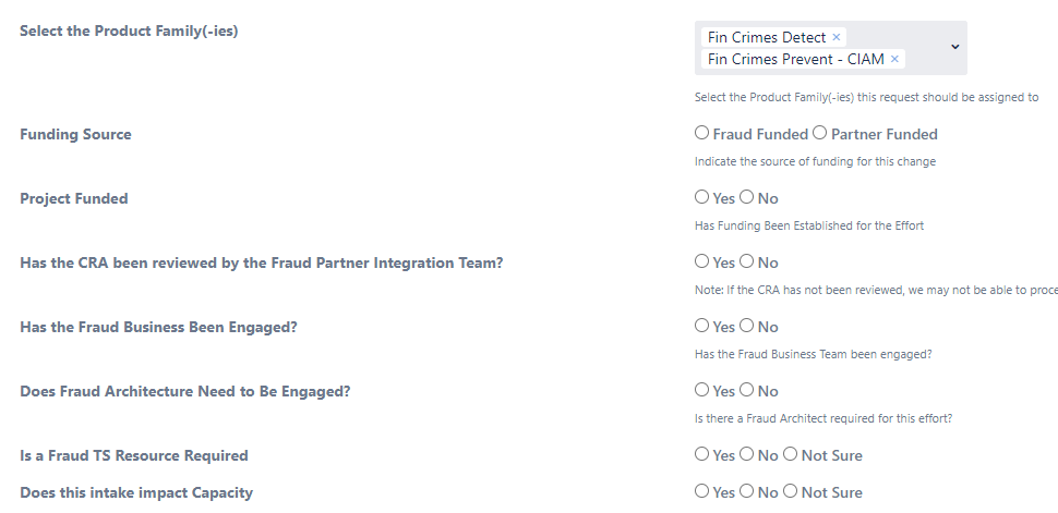

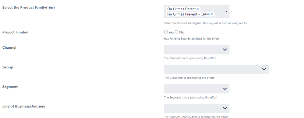

The issue I have is that if I choose option 02 first then 06 all fields show as required
However, if I select 06 first THEN 02 the required fields for option 02 are not showing up.
See the screen shots below:
Shows Correct
Option 2 is selected and the fields show as required
Options 2 and 6 are selected and the fields show as required
Options 6 then 2 are selected but the fields do not show up
