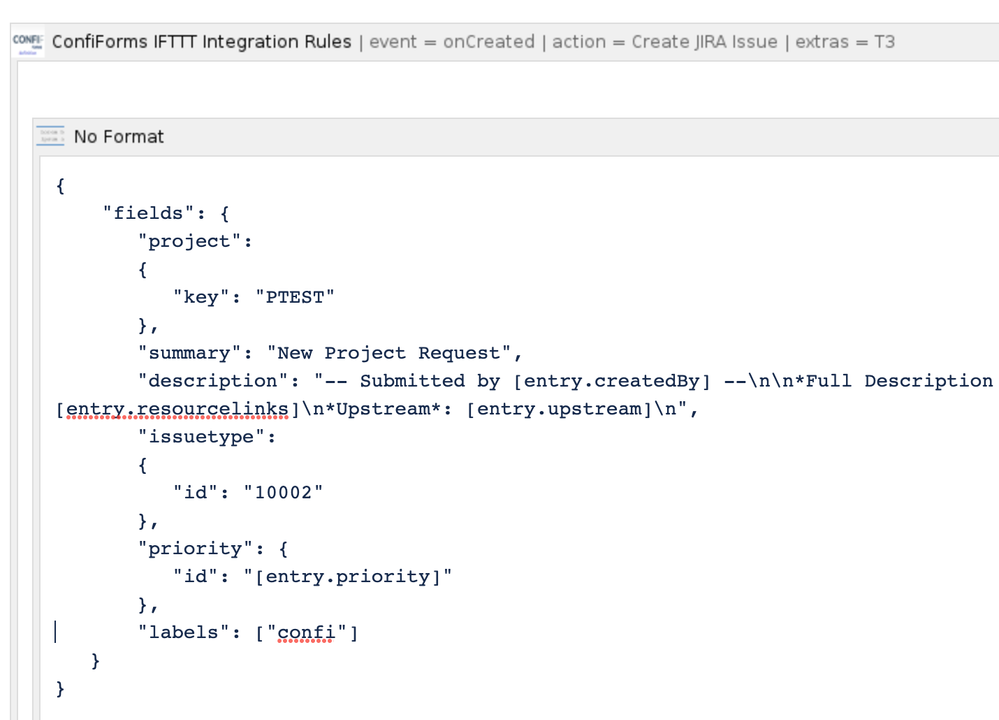

@Alex Medved _ConfiForms_ I use this method below to create an issue. It creates the issue successfully, but I also want to link it to another issue.
As mentioned above, it looks like Jira has a different endpoint for linking issues and it cannot be done during create.
Do I have to make a subsequent call to link issues after the create? Can you advise on how to do that?

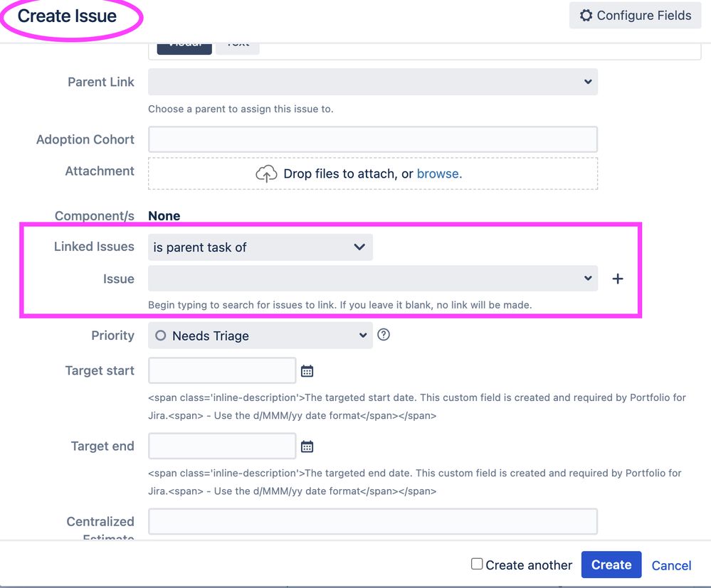

I'm referring to a system field in Jira called 'Linked Issues'.
Have you heard of this field? I use Confiforms to create an issue and that works great, but I also want to set the 'linked issues' field.
That requires calling this API also: https://docs.atlassian.com/software/jira/docs/api/REST/8.5.12/#api/2/issueLink-linkIssues
I can't seem to set that field on 'create' via Confiforms.
