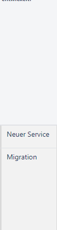

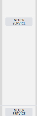

I have a screenshot of the unfiltered database of the form.
Here you see 2 entries of the row that are not imported.
In the next picture you see two of the imported entries. As you see they differ from the ones above. Thats the only difference I can spot tho. No difference in the .xls / raw

On the last screenshot, the way the value is rendered, actually indicates that is not found and is shown as is (looks like the text is imported, not the UUID)
