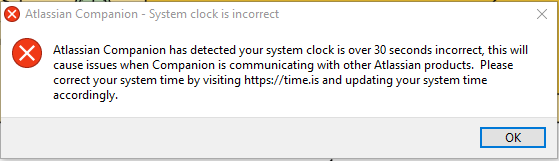

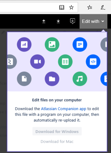

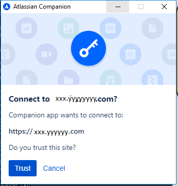

Some screenshots
Anyway. Clicking the "Edit with"-button, trying to edit any file now in Confluence, pdf, png, bmp, etc, results in that the "Download the Atlassian Companion app" dialog shows up. Obviously they do now know about each other.
