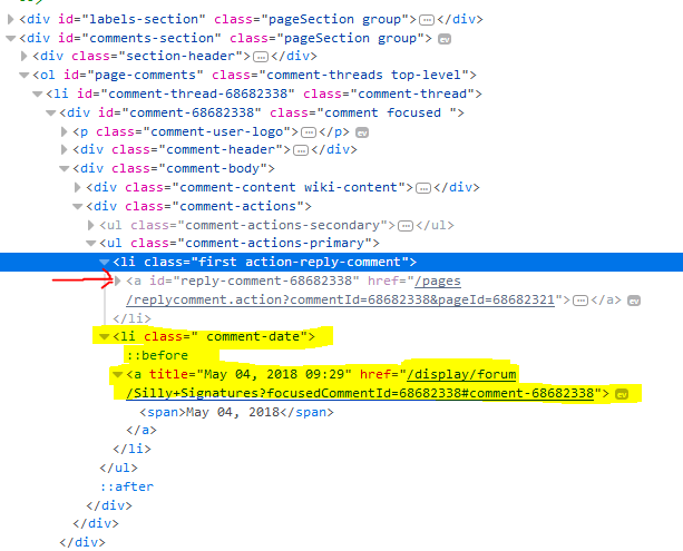

I was inspecting the page elements and noticed that the reply item is present, but not visible.
Please see below screenshot. Red arrow pointed to the hidden "reply" link. I have highlighted the date element which is showing as expected.
Do you have any suggestions of what could be making "Reply" invisible?
Many thanks

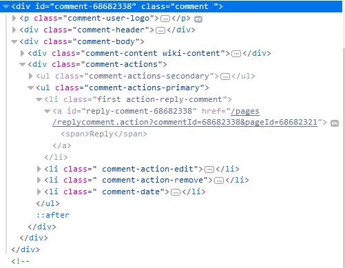

Here is the expanded reply-comment div -
I'm logged in with different permissions, so edit and remove are showing, and work as normal.
I've tried browsing to "https://server/pages/replycomment.action?commentId=68682338&pageId=68682321" but it did not work. Should the format be different?
