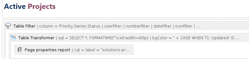

I have the Table Filter on top, then the Table Transformer and Finally the Page Properties Report.
It works fine for the most, however after adding the Table Transformer the Table Filter is not doing its sorting anymore. I have chosen to Sort by Prioirty column, that used to work fine, but now its listed a bit random. Have to physically click on the Priority Header to get it right.
The Table Filter does work with the pre-set filters though, and only shows me what I have pre-selected, so its not entirely not working, just the sorting bit.
Any help appreciated!

However, I tried to change the sorting now to one of the other columns with no dropdowns, "Owner", which is plain text and that didn't work either. Usually, before the Table Transformer, I would use both Priority and then Owner.
The filters work though.
Tommy

Seems like I found a workaround. I added this at the end of of the Table Transformation code:
ORDER BY Priority ASC;

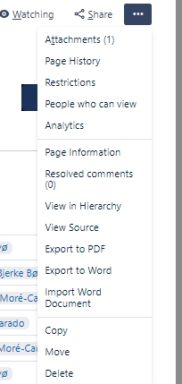

I am not an admin in our Confluence instance (yet), but from the looks of it (by just clicking edit on the table filter) it says in the top right of it that its v10.1.2. Also tried to find "view storage format" on the page that holds the page properties report with the table filter macro and the table transformer, but I don't think I have "view storage format"

The View storage format option is also enabled by your Confluence administrator or he/she may do it for you (for them it should be always visible).
