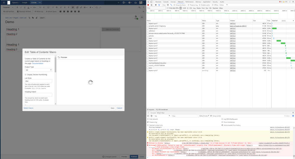

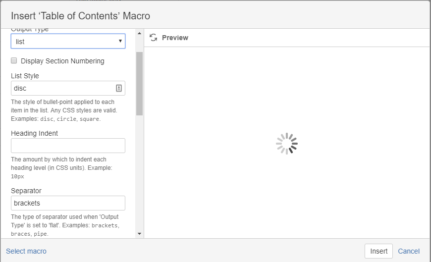

I have Confluence 6.6.0 installed and one strange thing I have seen is that Macro preview dosen't load in Google Chrome. (same problem at 6.5.1 and 6.5.2 too)
I thought it didn't suppose to load in first place but when I happend to use Firefox one day then Macro preview loaded in one second.

Gen Lee January 9, 2018
Yes, I have tested with multiple workstations.
Error occurs at latest stable Chrome aswell. I am running beta.

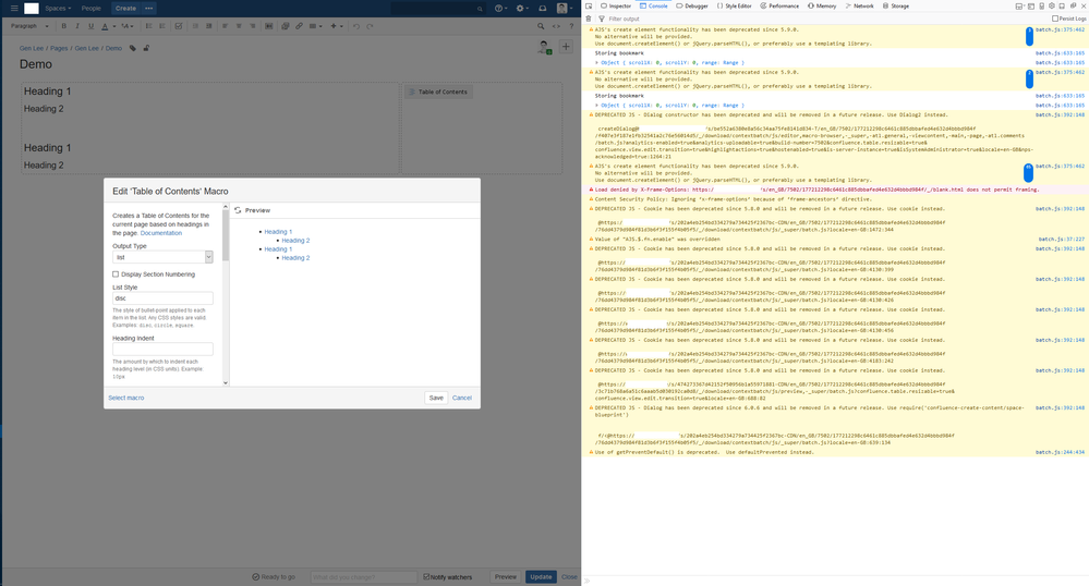

I attached images.confluence_preview_debug.pngconfluence_preview_debug_works.png
Shannon S
January 10, 2018
Gen,
Is that 2nd image from Firefox?
Could you tell us, do you happen to be behind a reverse proxy? Is there any special NGINX configuration?
I found another customer that had the exact same error, and they found that their NGINX configuration was set X-FRAME-OPTIONS = "Deny" which caused the issue.
If you have this setup you have a look at those settings and let us know if you find anything like that?

Gen Lee January 10, 2018
I have fixed the error with extra webserver parameter:
add_header X-Frame-Options "server address";
