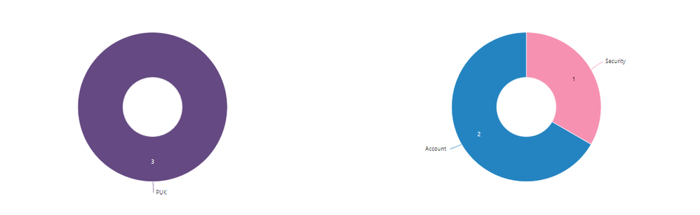

From this table I would like to create a chart by using "chart from table" macro and count the number of "key area" and "cluster" separately and to visualized it as a donut. I get the following results:
2024-02-20 12_37_18-test23432432 - Business Connectivity - Confluence and 1 more page - Vladimir Sta.png
This is correct, but I would like based on page 10-09-06  if possible to exclude the duplicates if any. So the expected result on the chart should be:
PUK = 2 and Account = 1.

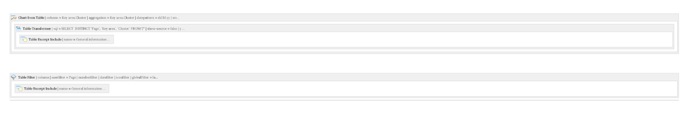

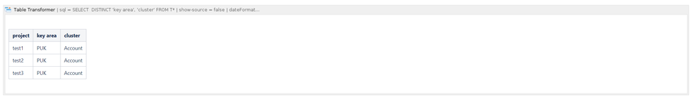

Then you may try the following workaround: place the Table Transformer macro between your mini tables that you collect and their Table Excerpt macros.
SELECT
DISTINCT 'key area', 'cluster'
FROM T*
Here we don't show the 'project' column (each cell has the unique contents, as I've understood) and remove the duplicates from the 'key area' and 'cluster' columns.
So, we transform your mini table into a one-row table and we collect this one-row table via the Table Excerpt/Table Excerpt Include macros.
Then for the result master table you'll be able to use the Pivot and Chart from Table macros as you've wanted firsthand.
Hope this workaround helps.

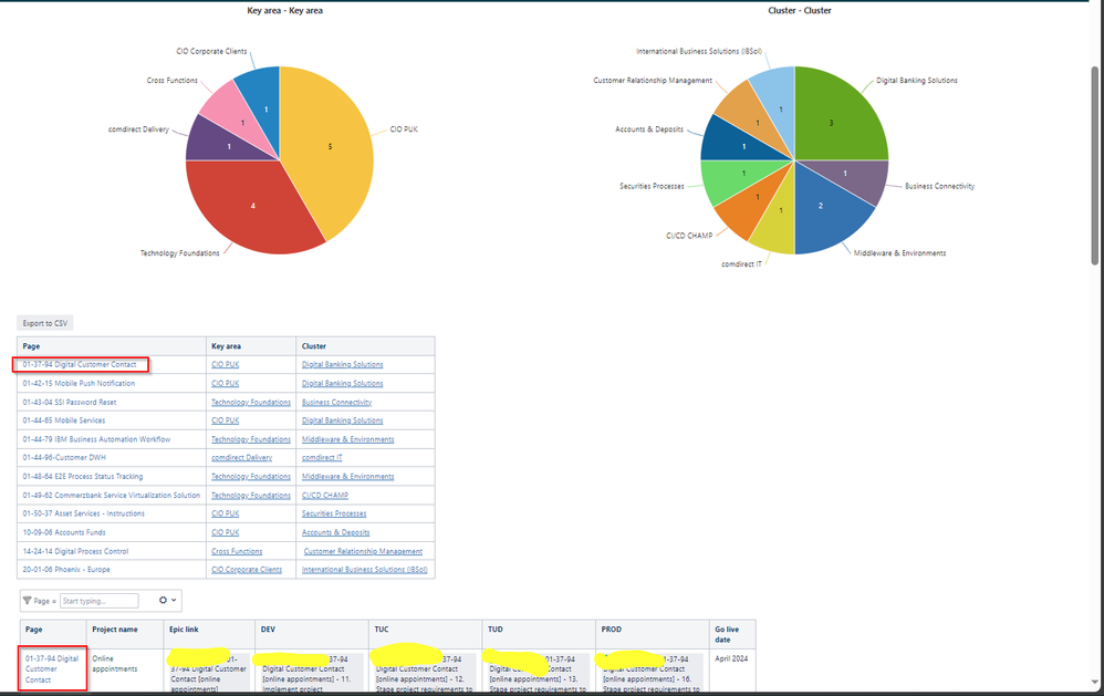

Thank you very much! This resolved my issue. Since I have to show the project column I just made a copy of the "Table excerpt include" in "Table Transformer" macro
And here is the output:
The report and the charts are showing now correct data! The red rectangles shows that the data is duplicated,  between the tables but this is not an issue.
