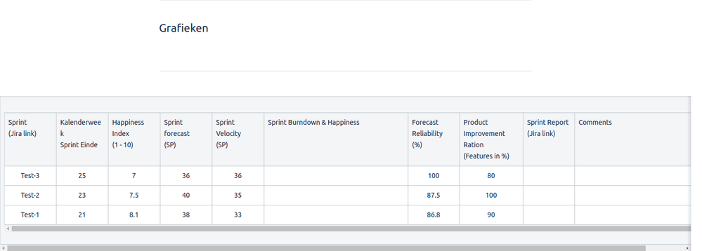

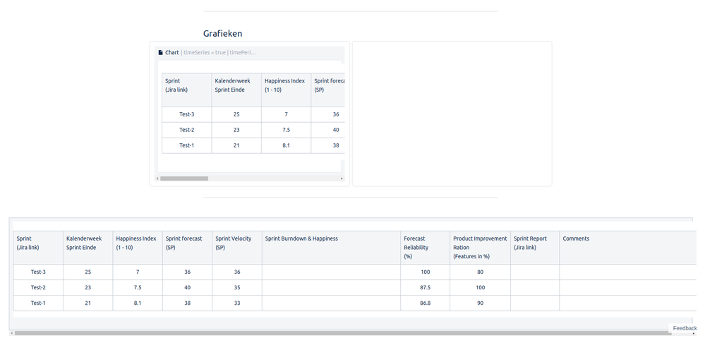

I am experiencing the exact same issue, also in Confluence Cloud.
The only difference is that my graph makes use of a table in an excerpt-include from another page. At the moment the table is filled with test data, so nothing sensitive to see here :)
I have tried adding the table directly into the chart (instead of using the excerpt-include), but the result was the same.
The reason I am trying to get this to work is so that our Scrum-master only has to update one table and that all charts and graphs will change.
If we can't get this to work, he has to change 4 charts and the big table after every sprint.
See the screenshots below:
Source table:
source_table.pngChart preview:
chart_preview.pngPage in edit mode:
Page after publishing:

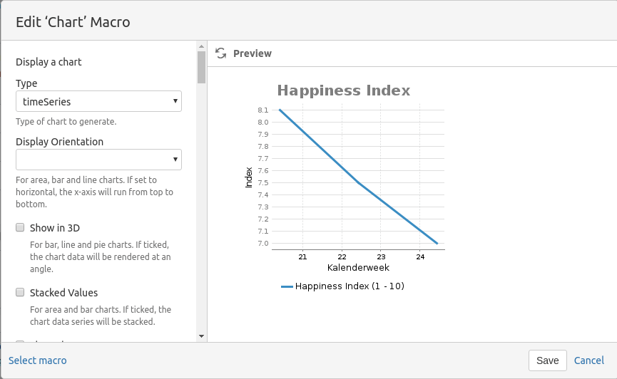

This is the preview I get in the macro preview viewer.
When I publish the page, I could send you a screenshot but basically Nothing is displayed.
