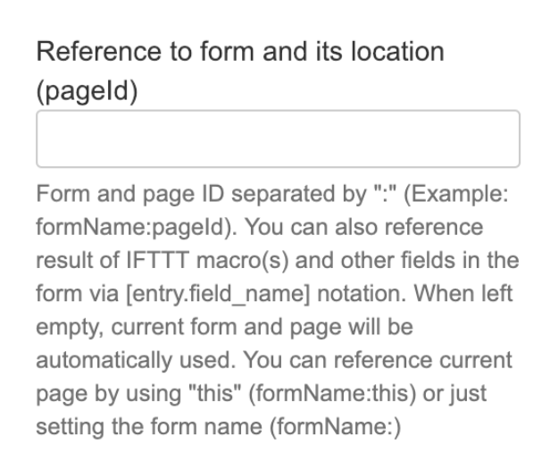

Alex Medved _ConfiForms_
October 15, 2024
You specify that in this parameter
In the format of
formName:pageId
Kevin Gleeson October 15, 2024
Hi @Alex Medved _ConfiForms_
I have done this and it still isn't working
Form name and pageId are correct.
