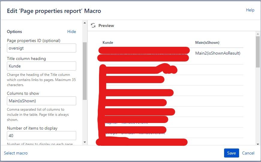

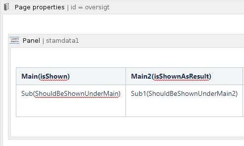

Hi, i have a problem with retrieving the right data from my panel which withholdes a table.
Do any of you know why the tables deliveres data horizontal, and not vertical, as i would like to and do you know how to fix it, if it is fixable?
it should show sub instead of main2 in the preview on picture 2, and if i put main2 in the colums to show it should show sub1. Thanks in advance

Hi @Christian Holm ,
Have you tried to change your sequence of macros and make the Page Properties macro collect just pure tables: table <- Page Properties <-Panel macro?
It looks like your table headers are messed up.

So if i put a panel macro around the pageproperties?
I just tried it, didnt work.
How have i messed up my table headers in the first place, i have tried to create a new table and a new panel inside the pageproperties as well one. That did not solve it :(

When i inspect the table it says that it is in fact a tableheader
Katerina Kovriga _Stiltsoft_
August 31, 2021
Maybe try to simplify your Page Properties Report - collect Page Properties by labels, not the id, show all the columns, etc.
For testing purposes, I mean. Maybe you've caught a bug or smth - do other Page Properties Reports work as expected for your Confluence instance?
